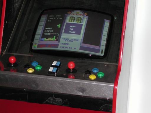

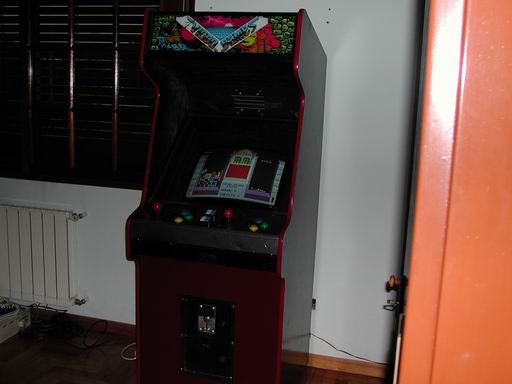

The TJT wrote:Show us a pic of your cabinet! 8)
Heh, sure!
Here are two pics.
They aren't recent, but appearance hasn't changed much.
I replaced those joysticks and added a volume knob, nothing else.
It is a generic jamma cabinet with standard-res arcade monitor.
As you can see in the pics it was a Tetris machine.
I easily converted it into a MAME machine using a J-PAC as the interface for video and input.
Current PC hardware is a P3 550E which handles many games well.
It is very cool to play the games with a real arcade! 8)
