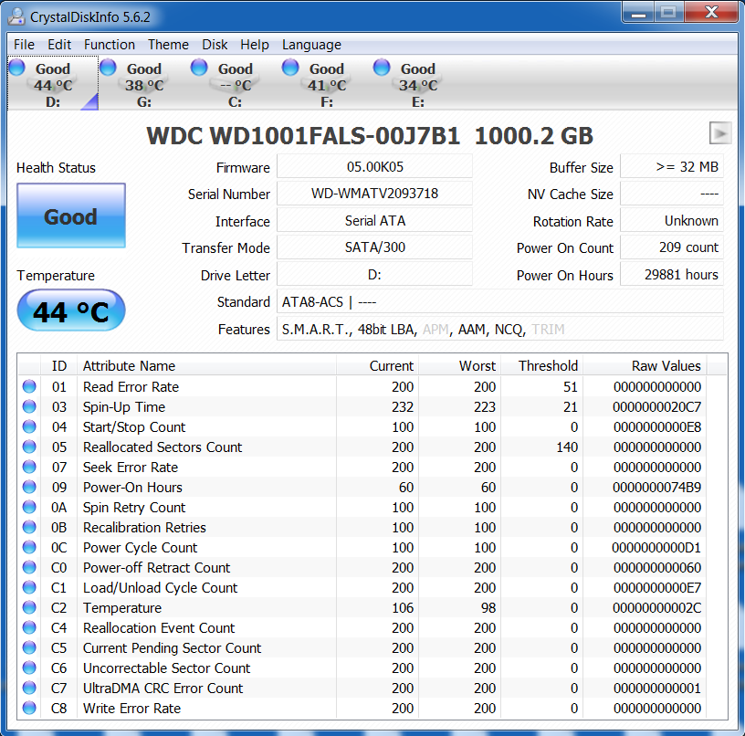

You're having so much trouble because your files are becoming unreadable on a dying hard drive. If you don't want to lose everything, get a new one and transfer your data over ASAP.kernzy wrote: 01 _59 _51 __6 00000D4CF03E Read Error Rate
05 _74 _74 _36 000000000428 Reallocated Sectors Count
07 _90 _60 _30 00003B92EA59 Seek Error Rate
Here's an example of what a normal drive should look like.
- HD.png (120.13 KiB) Viewed 10485 times
